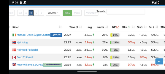

mjd1988
Love It when you enter a last minute race and it ends up being good. One guy with big 5 min power and poor sprint versus several others with a sprint and one decent climb. Managed to glue myself to his wheel in an eleven two man breakaway whilst 3 others later broke away from main group and bridged, then a bit of attacking and then fun sprint. Very happy with the relative w/kg efforts
