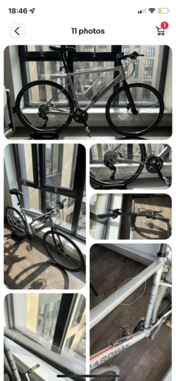

Ok. I have some updates. There’s a Boardman Hybrid 8.6 2021 on eBay that’s used, but in great condition and the seller is willing to gave it up for £250.00 (the original price is £550) and he lives near by too.

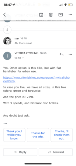

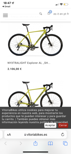

The other option is Vitoria bike which I found difficult to buy nowadays. I like how light they’re and apparently they’re good brand. I’ve emailed the company and they came back to me with the following. They offered me one with flat handlebar for €739 (please check photos attached)
