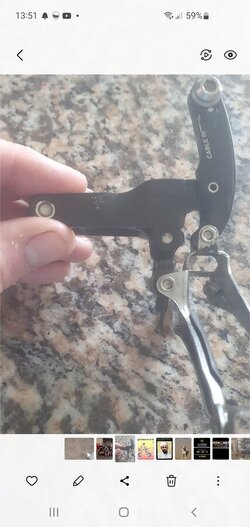

105 Front Derailleur wont fit
J
Jimmy Welch
You can get purpose made adapters for smaller seat tubes
https://www.sjscycles.co.uk/gear-sp...-clamp-band-adapter-unit-for-286mm-y5p198030/
Although that says ultegra in the heading, the compatibility list includes 105 for 10 (5800/5801), 11(7000) or 12 (7150) speed.
Cracked it , thanks very much
