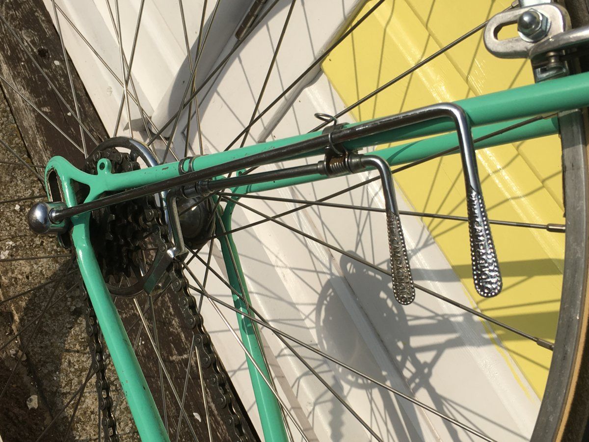

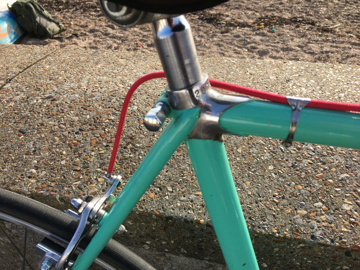

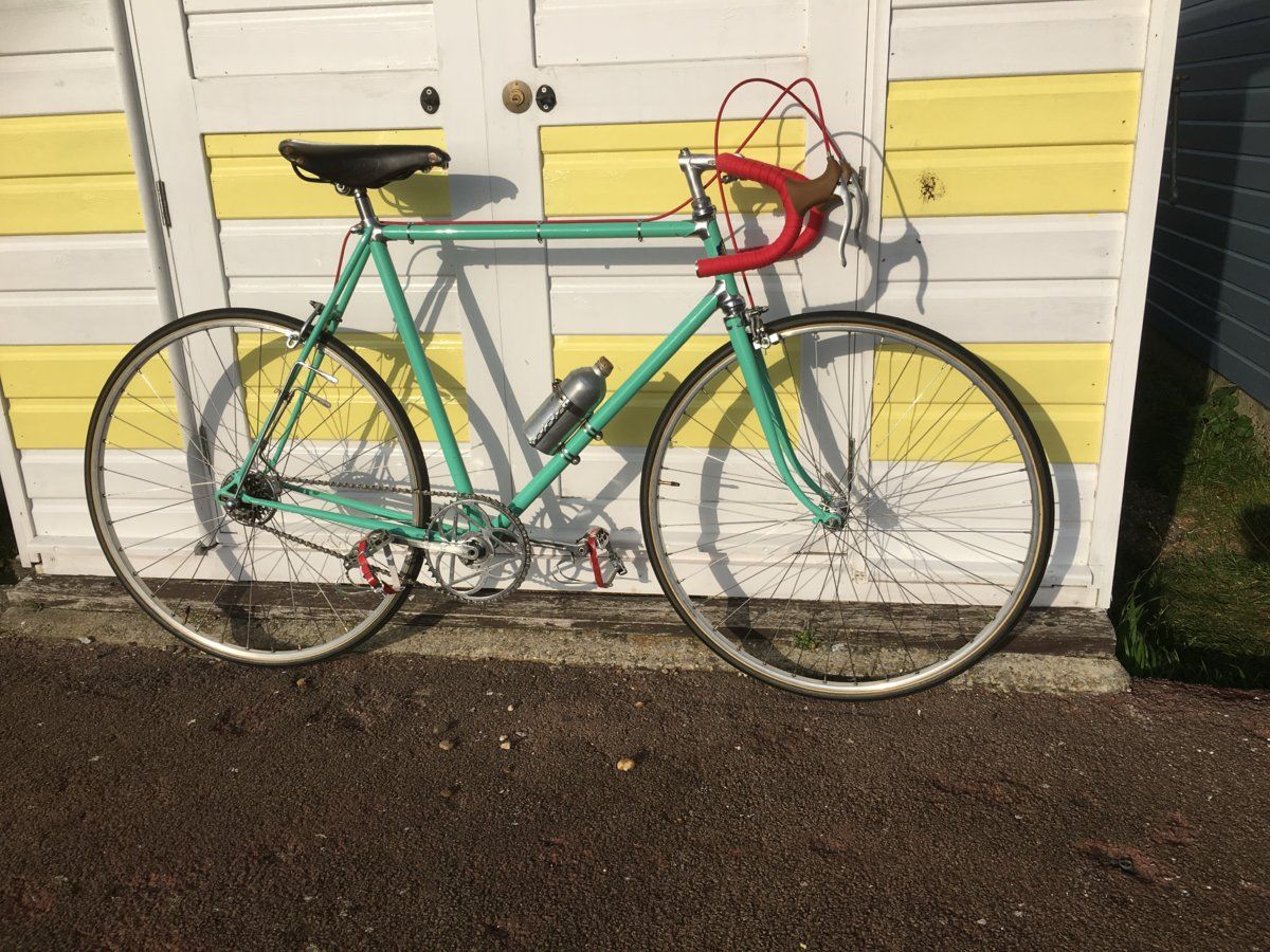

So, I went to Italy for my 50th last weekend, and came away with this little beauty. As far as I can work out, it's a Folgore, not a Folgorissima as the latter had the single-lever Campagnolo Paris-Roubaix changer, while this has the 2-lever Cambio Corsa. The frame number dates it to 1950/51, but any input or further suggestions gratefully received.
It's a beautifully simple system, if a little endangering for fingers. The longer lever acts like an extended QR skewer which you release while not pedalling. You then back-pedal and use the second lever to nudge the chain onto the required sprocket at the back, before retightening the QR. The dropouts are about 3 inches long and angled slightly downwards, so the chain tension is maintained by the whole wheel sliding back and forth within the dropout, forced into place by the rider's weight. It's kept square by having a toothed top surface.
It's very elegant and very simple but does mean that the 4 sprockets cover the range of 16 - 20 teeth, so it certainly puts hairs on yer chest.

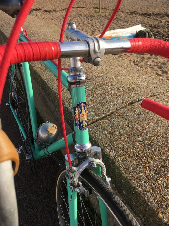

So this weekend I've:
  • Replaced cables and outers
  • Cleaned both rims and re-glued tubs
  • Fitted new cotton bar tape

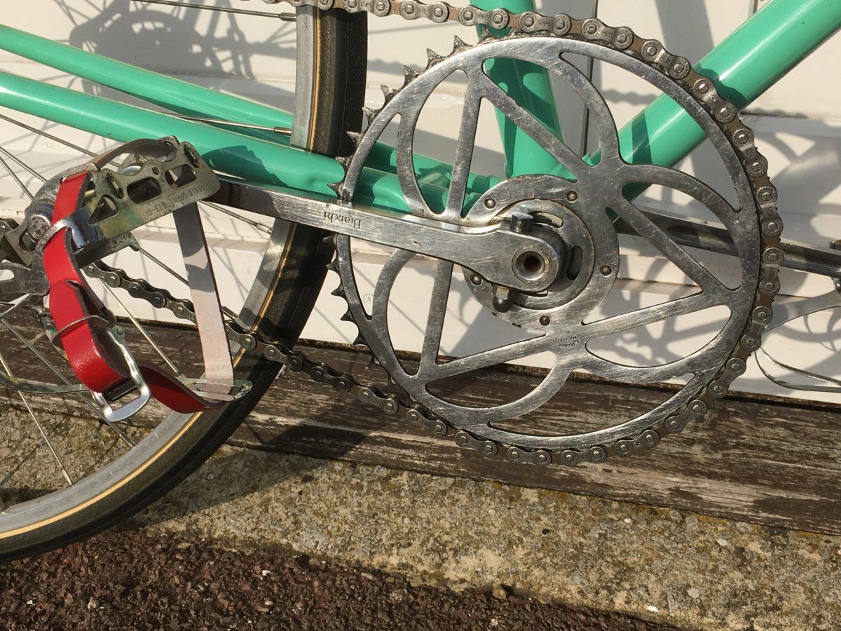

  • Fitted a new chain (KMC 1/2 x 3/32 work beautifully as the pins are almost totally flush, so don't catch on the chain guide)
  • Fitted vintage bottle cage and bottle
  • Fitted new old toe straps
I also put a pair of brown rubber hoods I had lying around on the brake levers, but I'm now wondering if they look too modern, being from a 70s lever.
I'm also wondering about the stem, but realise I'm now definitely over-thinking this!
I do fully intend on using the bike, not hanging it on the wall - though essentially as a singlespeed, in the 20t sprocket.
Am I missing anything? Any suggestions?

Very Nice, :becool: I wouldn't like to try changing gear whilst moving though, I think it's a select gear then ride set-up.
My thoughts exactly. I have managed to change gear whilst on the move and with all my digits intact, but given that even the easiest gearing is 48 x 20 I'm quite happy to leave it there! It does make you realise how climbing used to be based on slow, grinding, knee-busting power and not this new-fangled spinning malarkey!
