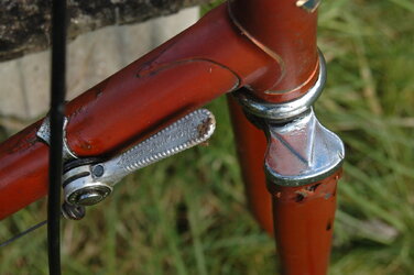

Hi Midlife. Illaveago and I had quite a correspondence on this one before he bid for it.
I think this is a real find. What a treasure to see the San Remo style seat stay wrapover on a genuine Olympic! During the 1960s it seems this detail was used on other models - my 1967 Super Tourist hast just that same detail. Doubly interesting because when it was introduced, the San Remo had the tubular wrapover detail which was to become the indicator of the Olympic / Super Tourist / San Remo model 80 through the 1970s!

There is a comparison with the Raleigh seat stay evolution. Way back when, the tubular wrap round seat stay was the hallmark of its top frames, light and stiff. Then ended up on the tru well Carlton and other middle range Raleigh stable frame

The classic Raleigh / Carlton / Falcon round wrapover are certainly hollow.
It might be the passage of time fudging my memory but I'm sure the Holdsworth rep said that their flattened wrapover was made in two ways.

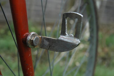

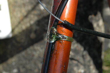

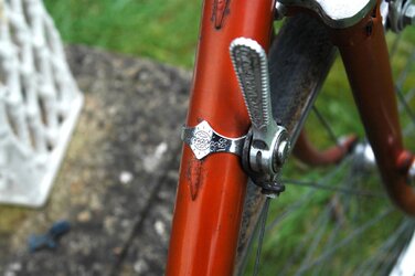

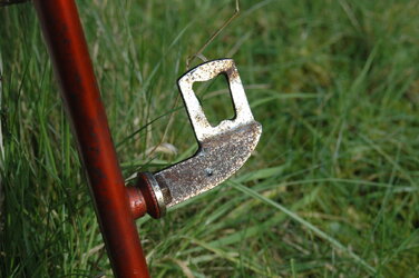

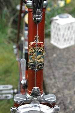

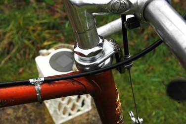

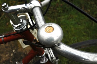

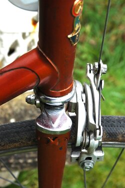

Here are some pictures of how it looks built up with some borrowed wheels. The original wheels are steel chromed with some rust. I did another 3 miles on it today. I was basically doing errands. Riding along in 1st and 2nd gear feels about right, normally I ride in 3rd or 4th. The chain only jumped a couple of times. I will look at it another day.
This afternoon I did a bit more cleaning and polishing. Most of the rust has come off the chromed bits, the frame is another matter. This received some clay bar treatment and polishing. It now shines in places. I managed to get some more of the paper sticker from the Reynolds transfer. What a place to put one!

Illaveago
Illaveago
Highly commendable! You must have been pretty keen to get it rolling! What are you going to do about wheels. They can be a pretty expensive part of restoring a frame. Will you go for period ones or later?
Yes I was. I wanted to see whatever it rode like . I am slowly getting used to it. I will have to swap the brake blocks for something else. They are Sturmey Archer, they look like normal rubber blocks but with some sort of fibre for the braking surface. They make a horrific screeching noise!
I haven't had a good look at the wheels yet. The chrome has rust on them in places but I'm not too sure how bad it is. The hubs need a good clean and polish and the bearings need looking at . They are a bit stiff. I will clean them up. I've cleaned up some which were worse and don't look too bad. The rust on the frame is my main problem. The scabs look bad but once filed down don't show signs of pitting .
I am keeping an eye out for cars which look a similar colour .
