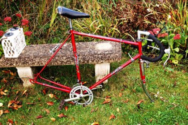

Here are some pictures of my frame.

No work on the frame today as it has been raining again. I have had a look to see what equipment it came with. A Sugino alloy double clanger. The rear mech was difficult to make out at first but it is an Altus. The front mech has charger on it. Weinmann centre pull brakes. SR alloy stem and bars. The frame number is 01747.

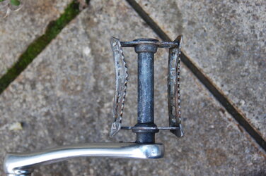

I've been doing some de-rusting today mainly on the pedals, there are quite a few areas on the frame but it's difficult to tell the difference between rust and caked on gunge. One pedal is cleaning up but the other is a grey colour, looks like the chrome has gone , it also has a dent in it so I will have to sort that out. I thought I would also move the handlebars as they were pointing down. I found that someone had been a bit brutal and rounded the corners of the securing nut. I had to get my needle files out so that a spanner would fit . Rain stopped play.

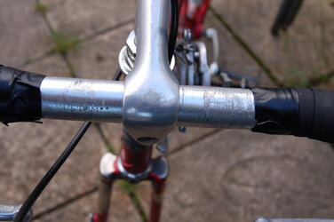

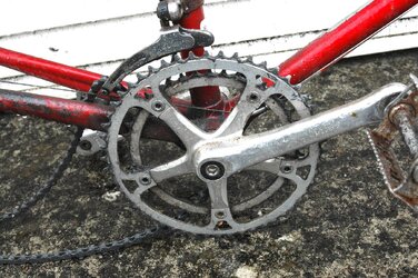

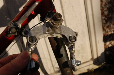

I'm still in the process of cleaning. Yesterday I tackled the front brake caliper and cranks with petrol. The black gunge is very stubborn and took some effort with an old toothbrush and petrol. The annoying thing was that the petrol softened it only for it to settle elsewhere. The bent pedal was sorted out using a hammer and a block of wood. The handlebars have scratches on the engraving which will require some careful work with a needle file.

Another couple of hours spent cleaning the gunge off this morning. I was going to try to remove the cranks as there is play in the BB. I put the crank puller on but all I succeeded in doing was to wind the end of the puller into the threaded end of the BB axle. I couldn't take up the play in the BB axle as the bearing cup has internal splines.
