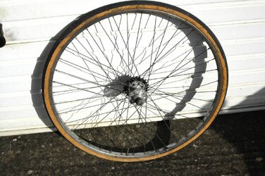

Here is my rear wheel for the bike.
I went for a long test ride this morning. It is a route I regularly use so it will give me some indication of how it performs. I had to contend with a headwind for most of my ride to this point. The ride back was much better.

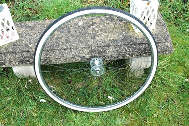

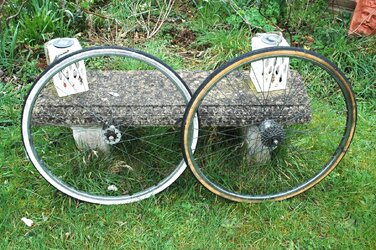

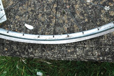

I had a go at cleaning up the wheels. They are chromed steel rims on large flange Normandy hubs. I wanted to see how bad they were and if they would clean up. The axles were very stiff but I discovered that all they needed was a good clean and regreasing. The rims needed a bit of a clean with some aluminium foil and white spirit. It looks as though one of them has been replaced as it is a German make, the other being a Rigida which could be an original. One of the rims has a few nasty rust scabs. I may just rub aluminium foil into it like I did on another steel rim of mine which came up looking a lot better. I gave one of the hubs a polish but it was only a quick one as I was starting to get cold working outside.
I can't help thinking that the high spec of the frame doesn't match the fact it has steel rims. As the rims don't match, there has been some change to them. However the large flange Normandy hubs, could be contemporary with the frame. They should have their date of manufacture on the outside of the centre barrel with the first pair of numbers being the numerical week of the year (01 to 520) and the second two numbers are the year of manufacture (e.g. 71 for 1971). I love this detective work!
Illaveago
Illaveago
I have just been out and had a look for a date but couldn't see anything. Mind you I have a bad cold! I did however notice that the front wheel spokes are thinner so I measured them . They are butted! 1.9 mm to 1.5 mm in the centre. That wheel has the Regina rim with the worst rust so I imagine that is the original. The rear wheel has a German rim with a Korean 5 speed. The bike also came with an old mileometer which used to flip round as the wheel turned. It is the later plastic type not the metal version . It has 4,003 miles on it .
