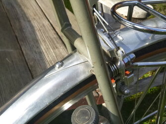

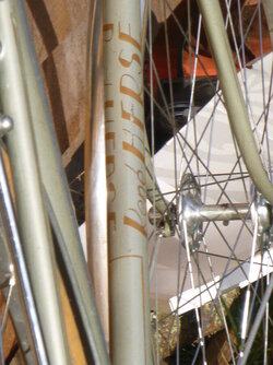

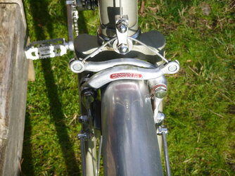

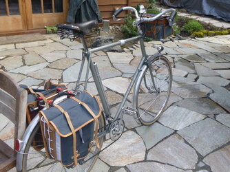

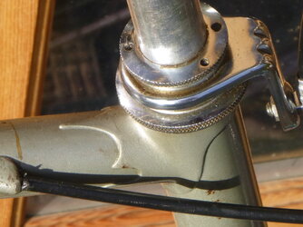

We were on a Tandem bicycle tour from Normandy>Nates>Budapest and encountered this 68cm Rene Herse advertised on a Paris board. This is exactly my frame size and my love of vintage steel frames combined with the incredibly rare occurrence of a tall Herse frame gave me pause and I arranged for shipping home.
I have a longer post here: https://www.bikeforums.net/classic-vintage/1245131-1968-rene-herse-gentleman-s-bicycle.html on this bicycle my modifications (all can be reversed)
Here are some pictures:

That is a LOVELY and well-cared-for René Herse! Congratulations on your good fortune and your good stewardship of this bike.
What components did you swap out?

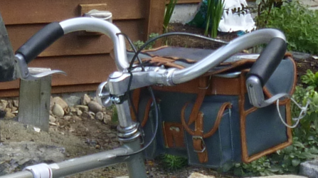

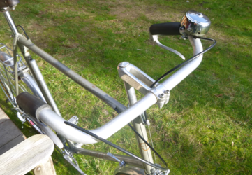

Because the bicycle became a daily commuter on a steep and hilly ride…. I made a few reversible changes to the gearing and provisions for a front bag. The old parts (freewheel, original drilled bars, derailleur, and such) safely stored away for someone that comes eventually down the road from me, probably when I’m 80 years old like the former owner.

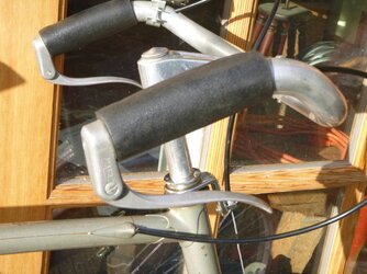

The bars were switched out because I wanted to attach the Nitto F-15 bag support that would have damaged the original porteur bars. The original Herse bars were the narrowest porteur bars that I've ever seen. Both bars are drilled for the cable housings that exit the MAFAC reverse brake levers. I enjoy the esthetics of the reverse levers and the choices that become available for the cable exit from inside the bars.

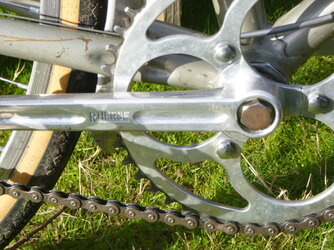

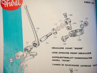

The conversion to the (up to) 16% grades that I commute on was mostly done with the addition of a clamp-on suicide shifter a slightly wider range of the French threaded freewheel and a bit of magic from Jan Hein with an adaption of the original cranks to a double. Shifting is not what one would call smooth but I don’t want to violate the originality with an actual Herse square tube shifter that’s brazed. My hope is that some day I (or the next owner) will be back on level-ish ground and can return the bicycle to the original unmolested state without any noticeable history of a former hilly life.
