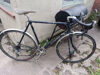

There's a thread about buying this and riding it home from Stratford in the "Travelogues" bit of the forum, but here's the rebuild thread. Don't expect any rapid progress on this one, it's way back in the queue and I've really only stripped it down so I can see what I've got and fit it in the shed! First photo is taken from eBay and shows the bike "as bought".

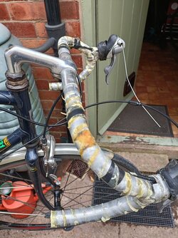

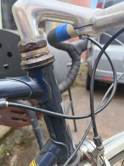

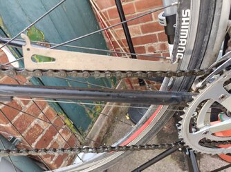

This thing is in a right state and the cat is not impressed! The stem is definitely stuck and (unsurprisingly) the chain is well past its best. I'm amazed this worked as well as it did on the ride home, to be honest.

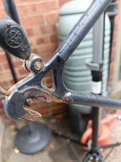

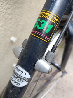

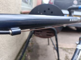

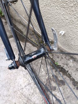

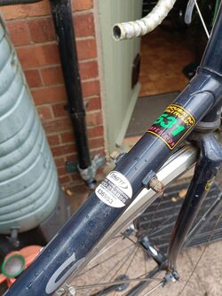

Stripdown begins. It's come apart surprisingly easily, which is nice. Even the downtube cable adjusters came off without too much trouble, and (amazingly) the rear dropout stop screws, which I was expecting to have to drill out, were both free. The downside is the rust on the nearside chainstay; I really don't want the expense of a respray. But this bike has obviously seen some action some time in the dim and distant.

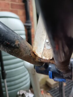

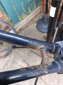

This is the only bit I'm really concerned about... Does this look like a scrap frame to anyone else, or should I sand it down and rattle can it? I'm not sure the frame is worth a proper respray, and it certainly isn't worth replacing tubes!
Looks pretty grotty, doesn't it? Probably a fairly highly-stressed area too.
I'm not experienced enough to have an opinion but I'd certainly tread carefully... worth using a chelating rust treatment rather than abrasion to keep as much meat there as possible?
I found this interesting video on council Evaporust recently, which I'm itching to try..

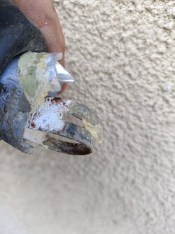

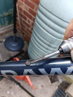

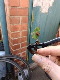

Oh, f**k it... I was just thinking how tapping out the threads is one of the most satisfying parts of the job.😂 Fortunately, I managed to extract the broken end by tapping it round with a hammer and screwdriver to unscrew it.
