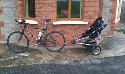

Kinda makes me wonder about these plastic and spring/strap build things. Mine trailer is a M&P 03 buggy, it's called an off road/running buggy. It's a 3 wheeler with pneumatic tyres and basic springs with a home made (such negative connotations) mount to the bike.
Many miles with shopping/children and at one point 12 stones of test weight, and nothing's broken yet. Cost me about €10 in welding wire and gas.

A pic of your handiwork would be nice.
Lanzecki
You wish is granted. Sorry thought I'd posted already. This was during the first test.
The mount to the bike is a pin and loop affair. Since this picture there is rubber to act as a shock absorber and noise damper. The vertical pin not has a spring loaded pivoting t-bar to stop it coming out. That said, the positions of the wheels put's positive weight on the hitch so it never came out. It would need someone hanging on the back to do that.
Connection to the buggy is by removing the front wheel. The red bar has the axle from a scrapped bike welded in that fits where the front wheel axle fits. The red bar continues under the buggy for stress control (spreading the load) and to stop everything bending around the front axle.
Since then the basic shape has change little, just been tidy'd and painted.
