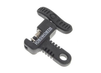

I've used a chain splitter when I came off last spring and broke the derailleur hanger. Used it to convert to single speed. I've got this tool from Halfords. Apart from being cheap, it's advantage is having the loop 'handle' on the chain splitter means you can use a metal tyre lever to get enough leverage to pop out a mushroom-head rivet easily when at the roadside and every thing is automatically twice as hard and awkward as it is at home. If you do get one I would advise a bit of threadlock/superglue on the bolts that make the hinges as they can tend to loosen, and a general lube and protection with oil or GT85 as it does rust up nicely in the saddlebag over a season.

See p2. A broken chain needs the damaged bit removing & replacing with a powerlink to get going again, or your ride is over.

- or as Svenbo points out above you will need one to shorten your chain in event of having to convert to single speed to get home after a derailleur problem. Also a very good idea to carry a spare quicklink too, although in emergency you can rejoin the chain using the chain tool (or re use the existing quicklink of course).

Not clear on chain splitters. What would be the reason to split a chain on a ride?
I've used mine twice last year .. once to help a friend out when his chain jammed on the inside of the chainset and no matter how much we fiddled in the end we had to split the chain to free it.
Second time is when a poor guy got his tracksuit bottoms totally fouled in his chain / chainset and again the only way to free him was to split the chain and save his embarrassment.
Before that I've had to use it myself once to convert to a single speed to get me home after a hanger failure.
It's one of them tools you consider, you'll have no use for, but when you need one, it's a god send :smile:
