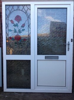

How about something along these lines? Photo chosen at random - you could of course have whatever combination you like and certainly not the fake stained glass. Lots of room for a motorbike with the right door, and better security as a nice bonus.
EDIT - re: condensation - this is going to be a problem in any bit of the house you don't heat (you insulate the door to the garage, don't you?). If I was choosing doors for your application in my space, I'd have a stable door for working in nice weather and vents front and back for bad weather. Or if I was wanting to be comfy all year round I'd insulate it properly and heat it with the house.
Liking the doorbell to let me know the food wifey has knocked up for the ā€˜workers’ is ready for collection 🤣 I’ll put it to her….
Yup. Yet another avenue to consider. Ta šŸ˜Ž
