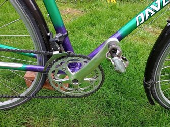

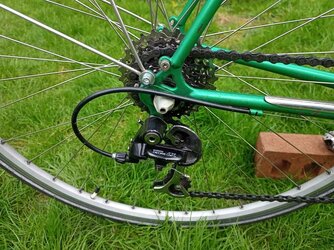

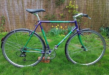

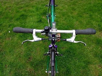

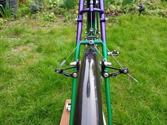

Thanks for the advice, good tips. I'll have to dig the frame out and take some measurements of the rear spacing. It was sold to me as a frame-set, plus some extra bits and bobs, but I will have to hunt to remember what I bought and where I've hidden those...
The intention is to go with a flat handlebar (as much as I like drops - I end up riding on the flats most of the time), and yes probably friction gears on the down-tube. It's just going to be nice practical bike, it sadly lacks front attachments on the forks but the rear has mounts for a rack, which is what I'd use more.
I was toying with finding a used Dawes Super Galaxy (in fact may still yet if I can find a 57cm), but this one has such a cool paint job I just fell in love with it. The wheelset was 700c, I've attached a few pictures of how the previous owner had it before it was stripped down. Part of me would like to keep it period correct, I've managed to find some details from the seller, who had an 8-speed Deore gearset. It was a pretty cool build.
I quite like the hunt of cycle-jumbles to find old parts, but definitely agree that older parts in good condition are getting harder to find and more costly. I will end up with a garage full of spares at this rate...
Thanks for the information :smile:
