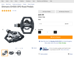

the single sided had a flat side on the other im after ones with a single side but no flat option eg
https://thecyclehub.net/shimano-a520-redals-review/

the pedals i am after have a bigger platform than m520s ( which i use for commuting ) , i can do long rides on that sort of pedal but prefer the bigger platform and the weight saving the pedal style i am after especially when clocking up bigger miles

- much like SPD-SL or Look Keo have larger platforms and are single sided. I use Keos in the summer and SPD (m520 clones) in the winter (as I use SPD boots in cold weather). I've also been searching for pedals like the ones cyberknight shows above, at a reasonable price. I use the minimal, tiny Wellgo single-sided SPDS (which are very light) on one bike but they can be uncomfortable on longer rides, causing hot spots with my shoes. Good luck with your search!
