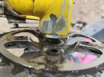

I just had to scratch that itch ^_^ A light sanding has revealed a covered serial number, i think? If this is a serial number it would suggest a genuine Holdsworth from 1956 (info from the Norman Kilgariff website). Or is it possibly a Colin Laing frame and those numbers refer to the date the frame was made? What are your thoughts please guys?

Am now in the process of doing a basic refurb on the bike as she's decided to keep it for sentimental reasons. Found something interesting when I removed the forks, the serial number stamped into the BB shell is also stamped into the steerer tube of the forks & the numbers match! So I'm now convinced it's a genuine 1956 Holdsworth Frameset (probably a Monsoon but not 100% on that) but it has had some work done to the seatstays/chainstays, as the rear dropout space has been reset to 126mm with a new brake bridge. Not too sure about 50's wheels but I think the dropout space would have been 120mm (or the Imperial equivalent) at that time.
