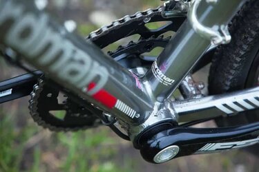

I still ride mine as a commuter, bought late 2014 and now has just shy of 21,000 miles on. Tyres, the originals are on my Wifes bike which seldom gets used. I ride on Schwalbe Marathon greenguard 700 x 35 and have mudguards which from memory are 45mm wide, so would expect no issues with fitting 40 profile tyres without mudguards.
Cycleops
Accra, Ghana
Between the chain stays would be the critical area. Doesn’t look to be too much more room.
