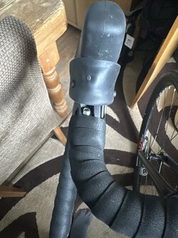

Yeah that’s what I mean and the front wheel was tiny buckle does that matter
disc wheels are not as critical for wheel trueness as rim brakes as the braking surface is the disc, that said its better to have it true if you can .A bike shop should be able to fix it hopefully by adjusting spoke tension cheap enough and even straighten the bars if you do not have the tools/ time or aptitude .
cyberknight
Do u think the bars look correct please confirm

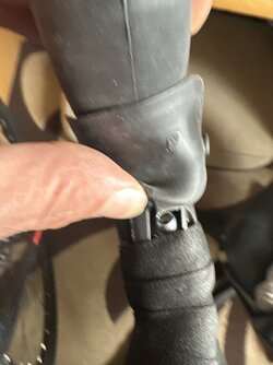

looking at the brake shifters , is that what you mean ?
the right one does look like its twisted on the bars , shouldnt affect function but you can either find the bolt under the rubber cover and loosen then straighten or get Neanderthal and just bash it a bit by hand till its straight .

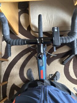

Bars look ok although the angle of the photo isn’t great. Post a pick dead centre with the top tube, stem and tyre all in line.

Hard to tell from the pictures do you mean the bars are not in line with the tyre?
if so its a fairly easy job to straighten them by loosening the bolts that hold the stem to the fork and twisting the bars till they are in line with the fork , dont forget to re-tighten !
bolt "d"
Do I use a Alan key to loosen my bars
