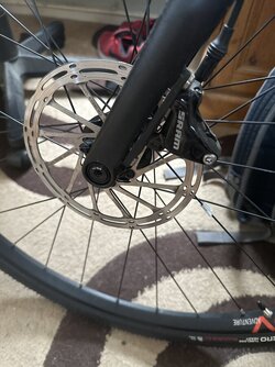

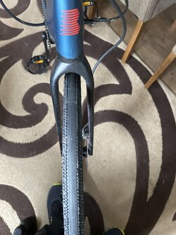

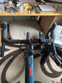

Thinking about I did what u did I think my sending you a picture of my bike tell me if anything lookes bent
J
Jet73
Formerly known as bike

Hard to tell from the pictures do you mean the bars are not in line with the tyre?
if so its a fairly easy job to straighten them by loosening the bolts that hold the stem to the fork and twisting the bars till they are in line with the fork , dont forget to re-tighten !

Yeah that’s what I mean and the front wheel was tiny buckle does that matter
