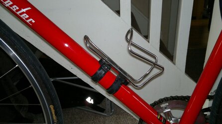

I use the VIP Elites on my Langster. Never had any problems since I put them on last summer

Thanks guys! Those VIP Elites look just the ticket. Shame they don't come in Silver!
