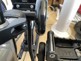

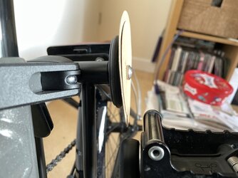

Picking up this thread rather than starting a new one; I'm considering upgrading the easy wheels on my P-Line to get a little more stability and ground clearance while pushing folded. And also because, well, it's nice to tinker with things right? It came with the standard 66mm wheels but I find that the nut on the end of the suspension block still skims the ground too easily.
I've seen the recommendations to try the Decathlon 66mm skate wheels, but on the P-Line I think an 80mm or possibly even 100mm scooter wheel would actually fit. In the below pics the crank is directly in line with the mounting bolt (so, as close as it can get) and there is plenty (about 31mm) clearance between the mounting point on the rear triangle and the pedal, so although heel strike is a risk the wheel (something like this
View: https://smile.amazon.co.uk/dp/B09PYW9CVD/
) should clear the pedal OK.
Has anyone tried larger wheels yet on the P-Line?

Took a bit longer than intended but... blingy 100mm wheels now fitted to my P-Line.
The ones I chose were approximately 24mm deep, so I've fitted them with longer screws (M6 45mm flanged button head) and they also had a larger 'axle hole' than the standard easy-wheels, so although the replacement screw itself is the same diameter, a nylon shoulder washer on each side of each wheel means they roll nicely. The extra weight of the wheels is noticeable when flipping the rear triangle under but oddly enough not really when lifting - and the bigger wheels should mean I can roll it in more places and for longer distances (the Waterloo platform...) anyway.
Yet to test ride to see how much heel-striking is a problem, but the pedals themselves pass fine so hopefully it will be OK!
