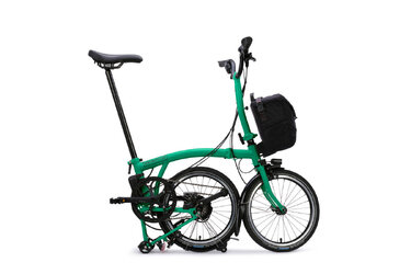

Anyone else noticed that the electric C Line has the P Line oversized headtube? But still with the steel stem.
