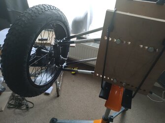

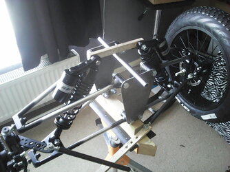

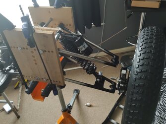

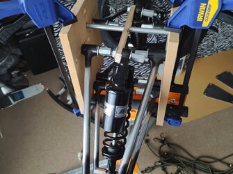

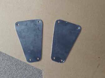

Just thought i would post a few pics of the build so far . The 1st pic is the suspension plates that will be used , as I am using MDF is a test bed . Pic 2 is experimental mount for suspension shock ( I have to get the height and width of the mount as it will be movable/pivot . You can see both the brake calipers mounted . The axles are just temp as I will be fabricating new ones . Nuts etc are also just temp as nylocks etc and the right length bolts will be used on the final build ... Will be working on the swing arm today and hopefully pics to follow

I have actually removed the MDF and fitted the plates . I really need , now to fabricate steering arms so that the "leaning" angle can be obtained and "stops" fitted , along with a centering mechanism to lock the lean so that it jusy steers without lean option .

If they're the standard axles on the two front wheels, they'll bend.
They're designed to support the weight on either side, not one.

One sided hubs are slightly different but only in the axle.
Hub body's and flanges remain the same.
Usually a larger diameter axel tapered down to the outside bearing however my ICE front wheels just have solid axles.

This is the front suspension unit ( not finished yet as have to yet design steering connectors/pivots ) I am fabricating curved support bars for the rear of the seat back and seat These will be attached to adjustable fittings so the seat area and the back will be fully adjustable . The frame will be used in other areas ( if needed) Just need the actual seat . It is 25mm ( 1" ) tubing on the seat frames . I have 25mm pipe fittings that will clamp and hold the seat , so it will be removable for transport . I have actually sat in the seat and its very relaxing ( I was going to contour the seat frame) but its fine as is and also , no need for a headrest as the back is more than high enough .. Saved me loads of money , rather than spend £200/$300 on a overpriced recumbent seat. Also using Carbon fibre rods to save weight and add strength . All in all . total spent is around £350 inc electrics so far

Axles are 15mm solid with M14 tapped thread . All full bearings in axles and hubs etc . The wheel axle as been sleeved inside to take more weight than will be actually applied 28mm solid and drilled out to 15.5mm for the axle . I have probably over engineered everything , but I know it will be strong and do what I ask it to do . Still working on the swing arm as my arthritis has been real bad some days , so just took it easy

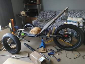

Well it's been a fair while since I posted i here . Still a work in progress. Arthritis took it's toll and I had to stop for a while . I am going to paint it in Kawasaki Green ( code 777) as you can see at the front suspension. Have a way to go before it's finished . Have to sort out steering and footrests . just toying with the angle to attach the swing arm to the main body ( I have since taken the photo , angled the rear tubing of the main body ) Seat is from an AB lounger , which i disassembled and in the process of mounting . I have made the recumbent to easily come apart for transportation with 3 bolts that hold the front suspension from the body . Seat will also fold flat or just be removed .
So that's it for the moment , ( I am currently spraying some components and lacquering )
