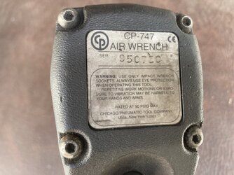

These were his though
Draper, plus a selection of ‘chisels’
I don’t have a compressor, but daughters b/f tells me, he has one that he doesn’t use!
No idea on tank-size, or CFM
Then again, now he’s bought a Defender 110 (TDCi), he might need it!! (& the above socket-set?)
