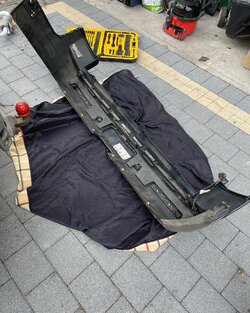

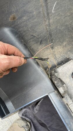

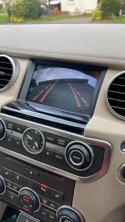

Just spent an afternoon fixing my PDC sensors on the Disco. Wiring loom had rubbed on the metal chassis underneath the bumper. Been annoying the hell out of me for 2 months. So decided to try and get it fixed. Broken wire managed to take out the sensors and rear camera . So all repaired now with some cable and solder. Now wrapped on cable sleeve .
