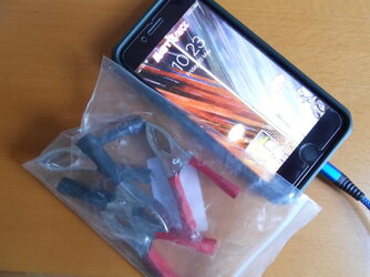

I’ve also ordered a set of ‘jump-lead’ clamps
I have a set in the Kodiaq, & also have another set hanging in the garage
The garage set were in my Land Rovers, & have an Anderson Plug at one end, the clamps are damaged
(must have been dropped & stood on at some point?)
They’re probably about a 500 amp rating?

That Anderton plug looks like a 120A to me, they come in 50A, 120A, 175A & 350A, the bigger the capacity, the bigger the plug, most material handling trucks now use REMA plugs which come in male and female, and 80A, 160A & 320A sizes.

I have a set like that, I used to have the Anderton connectors on all the vehicles (including the caravan), then a set of jump leads with a male/female connector near one end along with a set of big croc clips, if I want to use them just as normal jump leads just use the crocs, if I wanted to use the Anderton just unplug the crocs & plug the Anderton straight in.
