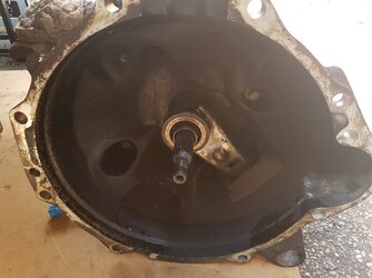

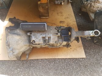

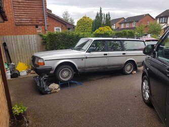

Volvo 240 clutch was changed on the drive. Prop out, gearbox out etc. Awkward and a sod to do single handed, but simple enough.
