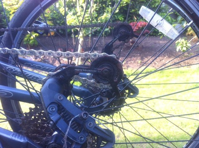

Bit of a boo boo! I was convinced the chain was the correct size (placed chain on each of the largest cogs), but I noticed tonight that it's a tad too long (it's catching on itself - might explain why it got stuck the other day). I've attached a picture - the carerra at the back is where the rear derailleur (correct part?) should be. The bike in front is the bike with the new chain. There's about a 45 degree difference (the rear derailleur needs shifting, by shortening the chain, 45 degrees up).
As this is a KMC chain, is possible to take the chain connectors out (push them without damaging) or would they need cutting, removing then new one's placed in (following the shortening of the chain)?

Assuming the two bikes are in the same gear, then yes, it does look like the chain is too long. You can shorten it by splitting at the chain connector, removing a link (you've got a chain tool I hope) then rejoining. A quick Google for KMC missing links suggests that some are reuseable and some aren't. Hopefully you've got the former.

Hi Tim - yes, I've got the chain tool remover - it's the KMC connector I might struggle with removing (mention on my post above about the park tool).
These are the links I have on the chain:
Might give it a whirl with some pliers I have, or try and devise a 'pinch' mechanism from anything I can find in my tool shed!
Probably need to remove 4-5 links I think...

I use Wipperman chains. I twist the chain into a Z shape around the link and find it works easily by hand
adamhearn
I've recently purchased a set of chain link pliers but have previously [struggled] with just hands and some harsh language. It's a new chain so shouldn't be too hard to pull apart at the link; an old mucky chain is a different ball game ;)
There are a number of ways to size a chain, check out Park Tool's guide for details. Then a tip for the future, measure the new chain against the old before fitting.

Twas indeed a bit tricky.
All my pliers (like my fingers) were too fat to fit in the chain, however my kitchen scissors worked perfectly!
Took around 6 links out, refitted and all seems well :smile:
Interesting to read that some take their chains off (this way) every few weeks to clean.
Will definitely measure the old chain next time!
