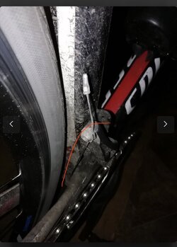

It looks like the cable is not routed correctly through the FD clamp. It is passing under and to the right of the bolt in an anti-clockwise manner. I think it may need to run from the left and be clamped clockwise, over the top. The lack of leverage caused would explain why you need 2 hands to shift gear and it has nothing to do with the limit screws.
Moodyman
Agree with the last two posts. Most Shimano bottom pull FDs that I’ve seen are routed as per the red line.
It will kind of work as is, though not as well and certainly not if dirty and dry.
The other thing to note is that your cable is very close to the right chain stay, possibly touching it. This will likely lead to damaging your frame over time. Move it as per the red line and you should clear the chainstay.

The red line position is correct, it would also give you a better swing, as the cable attached further away from the pivot and it will take the cable away from the chain stay.

Thanks but are you sure about that?
I just undid the bolt and noticed that there's a notch/groove on the RHS of the cable clamp housing. It'd put a lot of strain on the cable if I fed the cable into that slot with an "up and over the top" route.
I would not have thought that it would have put more pressure on the cable as it is further away from the pivot point. Did you try the red line position ? Think of it like a see-saw, if you apply pressure near the centre it is harder to lift the person but if you push the other end it is easier to lift. Does that make sense ?
I did try it, but there's no way to securely clamp the cable in place, taking the red line route.
The way that groove is angled, the intuitive way to route the cable is how I've got it in the original photo. Happy to be proven wrong though.
I tried to route it like this, while still using the groove. It seemed very unnatural, insecure and added strain in the bend.
