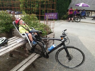

I use one of the hamax branded seats - I had originally wanted a rack mounted seat, but since using the hamax seat I've noticed there's a fair bit of bounce in the bracket which takes some of the worst out of the road.
I think a rack mounted seat would be a bit of a harsher ride for the child.
