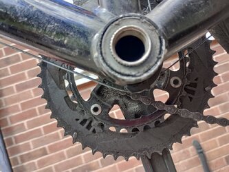

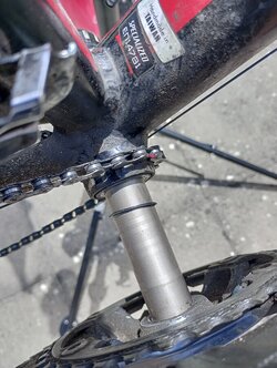

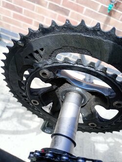

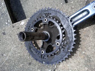

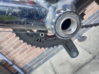

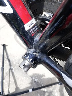

Just getting round to tackling this creaking problem... I've removed the crank arms with a view to regreasing the bb, but how do I ensure that when refitting the non drive-side crank, it's exactly 180 degrees from the drive side?

Can't you do it easily enough by eye?
EckyH
It wasn't me!
The splines on the shaft don't allow tiny misalignements. If the left crank is one spline off, then it's easy to see.
Additionally, there ist the small plate in the slot of the left crank. That plate has a small nib which goes into the small hole on the left side of the shaft. If the left crank is one spline off, the nib and the hole won't "match" and the plate sticks out of the slot in the crank.
E.
Cheers for this.
I was wondering what that little plate was for!
100% correct - that plate sticks out when misaligned.
