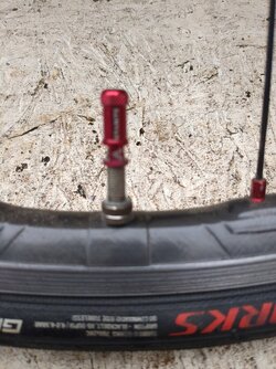

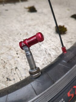

I have similar. One valve cap is a core tool, the other is a spoke key - which will come in handy if I ever get bored of having true wheels and want to mess them up.

bless, no its being used to tighten the valve core (or at least demonstrate the valve cap has that function)
Ah that makes sense.
Something strange with that inner tube though, it's got watery milky fluid coming out of it.
