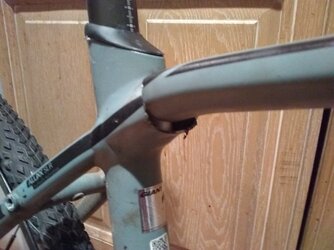

Check the frame for cracks.Take everything off the bike that might cover it and inspect it. I had a battery bag covering this break which I didn't find for several weeks, I just kept adding anti seeze to the seatpost as i thought it was the source.
I took the battery bag off for another reason and was a bit shocked!:wacko:
