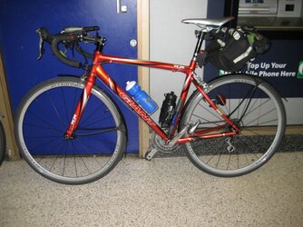

My ever faithful Giant TCR1 with Crudguard Roadracer MK2s fitted and Carradice Barley and SQR system for the FNRttS last Friday.
I love this bike :tongue:
