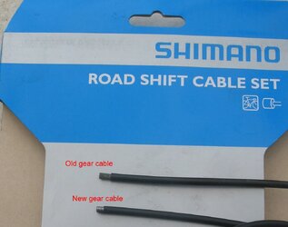

Thanks for all the replies. There's a lot to digest here but i'm midway between having a tooth extracted and buying a new car! I'll reply in more detail later, but here is a pic of the old gear cable and the new gear cable. Both ODs are approx 4.3mm; the new (Shimano) cable is slightly smaller and AFAICS spiral.

Just because it is in Shimano branded packaging it doesn't mean that it is Shimano, there's a lot of counterfeit stuff about, specially consumables. I can't see any part number in the label, which isn't a good sign.
I think you're spot on. I didn't examine the packaging properly and it's not the same as on the amazon webpage that i bought it from.
I bought this
And received this (if it's even genuine, which i doubt)
Which is 2.99 in Cycle Store at the moment. B******s! I'm returning what's left of the set to Amazon
Having said all that, it's not causing the problem with my shifting; it was showing the same symptoms before i fitted this cheap rubbish.

Both amazon marketplace and the bay are notorious for counterfeit stuff. I got stung on the bay with a fake shimano chain that rusted badly after the first wet ride. When I went to complain about the seller they had already packed up and closed shop.
