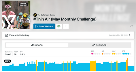

bobinski
Tulse Hill
2 hours Z2 outdoors yesterday and a short row followed by one of my favourite Sufferfest videos today-THIN AIR and the battle to keep The Shark at bay. For me some interesting numbers that suggest ftp at 235w is a touch low, especially the HR nujmbers 15 bpm on average lower than the last time i di the ride when NP was 12 watts higher. Fatigue? Doubt it.
Onwards and upwards!
