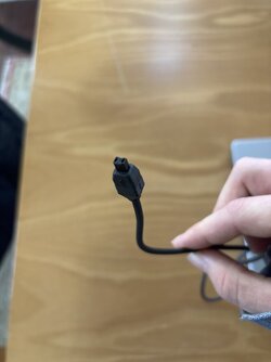

I recently purchased a Canyon Ultimate with di2 but cannot find where to charge it. I have looked around the rear derailleur and there does not appear to be a flap, also nothing in either end of bars. It looks like it should charge from the junction box however it is fixed under the bar stem and not sure how to get it out without breaking something. Any advice appreciated.

Charge port is under a little flap on the junction box, usually on the left side of the stem if the cables come out pointing forwards. I think you pull the flap down from the top. The junction box should also slide off it's mount to the left of the bike as well if that helps you get the charger connected.

Thank you for your guys help. Ended up just being a push fit of the junction box into the stem which I had to pull a bit harder than I wanted to.
