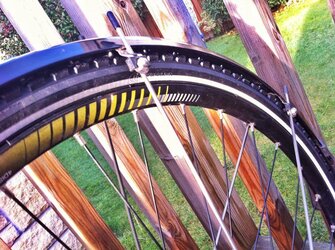

Having had no complaints about the speedy delivery of my tyres from Germany earlier this week, I managed to get the Winters fitted today as anticipated, and now just need to take it easy on my first couple of commutes to bed the studs in.
I had a nagging doubt that they might not actually fit – once I had one tyre on the rim, the 700x35c Winter did look significantly larger comparing it side by side with my 700x32c Conti Touring Plus tyre.... Turns out the mudguard clearance is fine though, so if anyone's wondering, yes, you can fit these tyres to a Boardman Hybrid Comp with SKS Longboard P45 mudguards :thumbsup:

i see you had to bend the front left stay of your guards??
That's right – a necessary evil with the BB5 disc brakes, but really easy to do. At first I put the stay through the calliper (which I'd spotted on a previous thread), but I wasn't 100% happy with that, so straightened and then re-bent the stay so it routed underneath the calliper. Works a treat :thumbsup:
