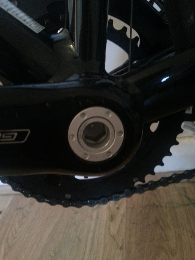

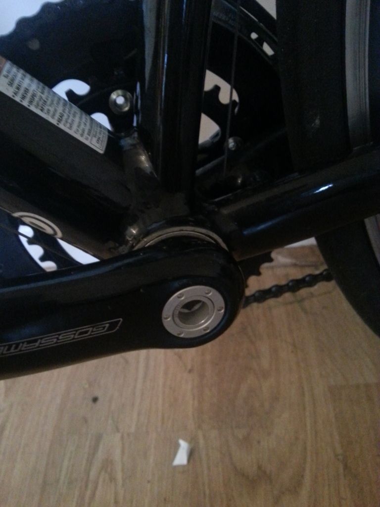

Do I need to tighten this some how?
Chrissymx
Active Member
Im getting a lot of creaking a clicking noises coming from down by the crank. It only comes when you put pressure on it like when your climbing or pushing a big gear.
http://i152.photobucket.com/albums/s174/ChrissyDCI/20120919_173732_zpsa78166d4.jpg
http://i152.photobucket.com/albums/s174/ChrissyDCI/20120919_173737_zps02e4f392.jpg
I have tried an allen key in the center (see link) with my 'big ratch' on the end of it and it seems pretty tight. I didnt want to push too hard though encase anything broke.
What do you guys think?
Cheers
Chris

Don't just keep tightening stuff though. Strip, clean and re-grease as you go.
If the noise(s) prevail have a look HERE for more ideas :thumbsup:
[EDIT] Just actually looked at the pics and it looks like a BB30 set up to me. In that case definitely strip, clean and re-grease. BB30 is notorious for creaks.
C
Chrissymx
Active Member
Both the pedals and the wheel needed nicking up a bit.
Done them and the noise is gone :-)
Smokeysmoo - the bikes only done about 800mile. How often should I be stripping this down and re-greasing?
Thanks both
Chris
