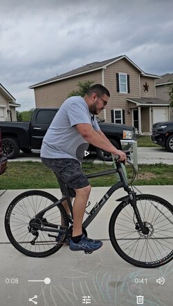

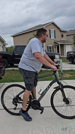

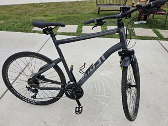

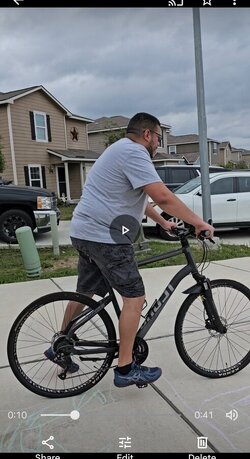

I am 6'2", which puts me in the XL frame size (sometimes large) on all the different manufaturer charts. I picked up a XL GHOST Square Cross 1.8 second hand, without even trying the bike on for size. I haven't ridden a bike in a good 20 years and didn't want to embarrass myself eating pavement or what not in front of the seller.
I'm a noob but based on the .883 rule for saddle height I have to slam my seat all the way down to get the correct height. All else seems comfortable enough, although I have only made it a little less than 4 miles in a little more than 20 minutes due to being out shape.
I've also measured my inseam and got 82.5cm or about 32.5 inches. I plan to measure again just to double check but pretty sure it's correct. Measured with no shoes on.
Anyway, back to the tip tube height. When standing over it, my ummm mid section we will call it, sits right on top of the top tube. Is this a big issue? When I stop, I just lean the bike over a little to put my feet down. I'm not sure if that is how to correctly stop or if I am doing something wrong? I have no issues finding another bike but wondering if I am risking my safety (mid section) or if I should just stop overthinking it and ride what I have?
Attached a few screenshots of me taking off on the bike, the 2nd time I got on it, in case that matters any.
Anyway, let me know if you have any thoughts.

Hi Philip,
I'd say that looks about spot on.
Standover height ceased to be a useful measure as soon as top tubes started sloping (blame Mike Burrows and the Giant TCR 26 years ago) My preferred ballpark method is to put your heel on the pedal at its fullest extent. You should be able to just touch the pedal with your heel with a straight leg and without rocking your hips. (Use a doorframe and pedal backwards with both heels - see if you have to rock your hips)
Don't worry about 4 miles in 20 minutes @ 12mph - just spend more time on the bike! That's a perfectly fine average speed, besides which, for all we know that could be 4 miles up the side of a mountain and into a headwind!

Completely normal. If the saddle is at the right height for pedaling, you will not normally be able to put both feet on the ground at once, you just lean the bike a bit to the left and put the left foot down (or the right if you are in a country which drives on the right always best to lean away from passing traffic, even if it is only a slight lean).
If your leg is just slightly bent at the bottom of the pedal stroke with the ball of your foot on the pedal, then it is about the right height for you. The leg should be pretty well completely straight if you put the heel on the pedal, but that is not how you will actually ride.
Standover height really doesn't matter much with modern bikes, it is stack and reach which are the two most important measurements.
The quick and easy way to set saddle height is to make your heel touch the pedals with a straight leg. As you ride correctly with the ball of the foot on the pedal, you will have a safe amount of flex in your knees.
It looks about right. Body proportions do not always scale with height so those % figures may only apply to med riders.
Remember that the crank length has not been scaled up to XL so you are riding Med cranks.

I'm a bit confused, as this is not what your photos relate to, they're showing you on the saddle.
On the saddle, if you can get the tip of one foot on the ground with the other on the pedal that's ok, but as you say, you want to be able to stand over the top tube without getting your tackle crunched. Only you can say whether that's a problem, but remember to consider the possibility that you might be standing on a level that's lower than the wheels if the ground is rough.

Great point! And yeah, sorry for the confusion. I didn't take any pics when standing over the top tube so figured the pics would at least give some scale to my sizing and the bike sizing. Ie if the bike looked overly too big for me, etc.
