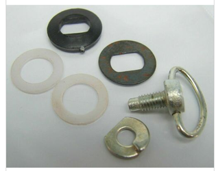

I can't seem to find anyone offering them over here, I found this on the internet and it is the sort if thing that I mean
In this case it is from the US and has something like £16 p&p.
The new options, in 8 speed seem to be Tiagra level, a Sunrace or a Dia-Compe none of which are that appealing visually.
The used option is unattractive as the condition will be unknown/I am unwilling to cough up £100 plus for NOS which still have the effects on aging on the plastic friction parts, hence the refurb.

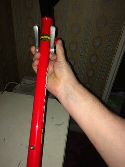

Sadly I am not a photographer, the left hand shifter is the old 600, the right a new SL-400, it looks a lot worse in the flesh.

I've repaired a few friction shifters by adding thick correct diameter size rubber washers between either faces. Just replace the new rubber washer when they wear, not as good as the original washers, but better than nothing. Measure your existing washers for the correct diameters.:okay:

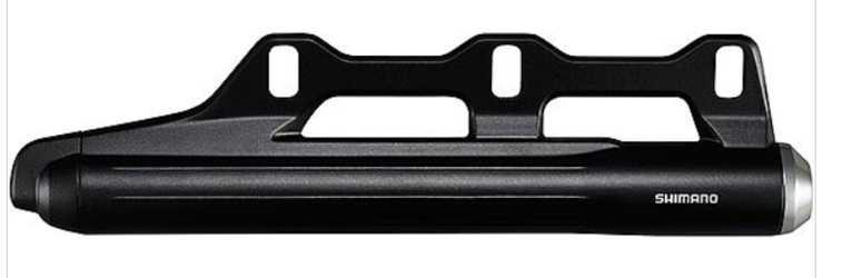

............. unless I put Di2 satellite shifters on the downtube and get one of these to mount the battery by a bottle cage,:laugh::laugh:
