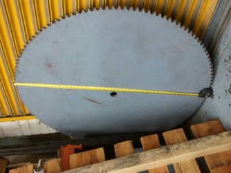

Who is going to ride this bike - The Hulk ! :laugh: 75m gear :eek:

I think I might have found your ideal front cog in our spares department at work:

I hope you've got long legs :biggrin:

How many teeth is on that thing. ?
