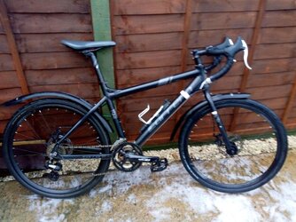

The main reason I linked that particular type of shifter is that my experience says road front derailleur are NOT the same as MTB, even if the rears are. Those are fully STI compatible versions meant to do precisiely what you are wanting.
