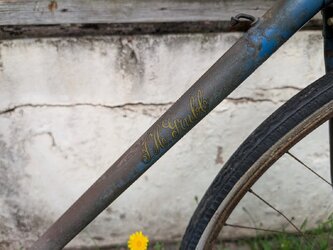

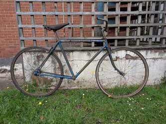

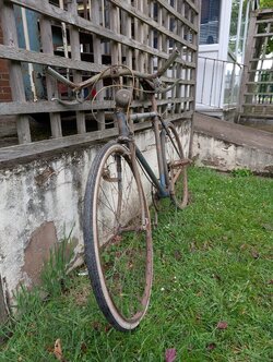

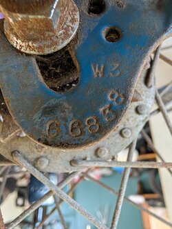

This is another donation to Enviroability, currently listed on their eBay. Much as I hate the phrase, this one really is a barn find. When it arrived, it was fitted with horrid modern drop bar brake levers as well as two different gear shifters (Sturmey Archer and Cyclo) and a Cyclo rear mech, all operating the lack of gears on the fixed/free hub it was also fitted with. I think it's late 1940s but beyond that I know nothing about it. The frame number does not seem to fit with the online database I found. Anyone know anything about this bike?

Probably sacrelidge to most old bike 'enthusiasts' but I'd actually keep the frame as is and fit some modern in-keeping parts from the likes of Velo-Orange, Rene Herse etc., with bar end levers single chainring etc.
Somewhere I read:
Tradition isn't keeping the ashes but passing on the amber.
In particular the brakes on this frame would be my main concern if someone will be riding it.

You're right.., 66838 is not a Grubb number. The decals do not match the timeline of the frameset, either. Those are Holdsworth designed decals, and they did not begin building Grubbs until 1954, well-after eyelets were re-located to the bottoms of the fork ends and dropouts. Have you checked the steerer tube for numbers? If there are no head-badge rivet holes, then it is not a Grubb.

Yes, the steerer tube number is the same as that on the dropout. The mystery deepens... I wonder what it is?
