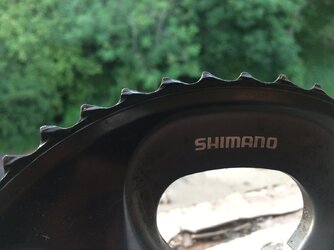

Good afternoon,
I am often surprised by what does and does not work and when confused just give up and replace everything with new bits.
I noticed that you said newer, not new which opens many cans of worms, such as a bent ring or a few teeth dodgy teeth.
This chainring worked except under full load
but the inner ring which appears unworn slipped with both old and new chains.
