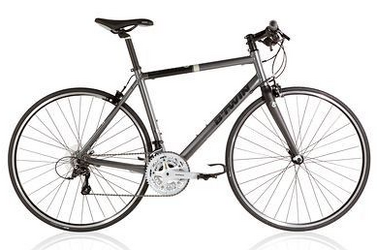

Really pleased with my BTWIN fit5 after 5+ years,
it's similar to a triban but comes standard with flat bars
my first time, please could you advise on what compatible 52 or 53 T chain ring I should purchase?
currently I do not use the two smaller, the large chain ring I believe is 50T, I fancy going a bit higher to 52 or 53.
Rides are mainly flat with a few hills around town, could be my cadence but I feel like I could do with an extra gear at the top end.

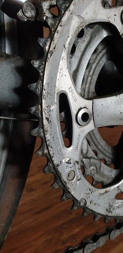

You need to measure this and then scour the internet for a chain ring with the same BCD.

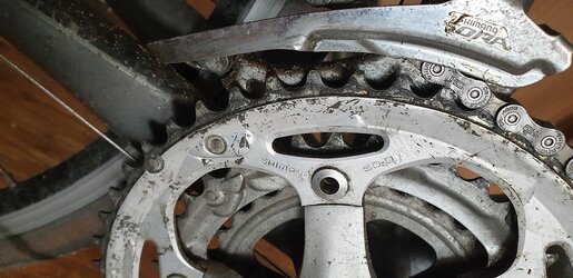

Good morning,
.... currently I do not use the two smaller, the large chain ring I believe is 50T, I fancy going a bit higher to 52 or 53.....
Given this, this may not matter, but front mechs do not have an unlimited capacity and the inner plate of a tripple is often stepped.
To fit a 52t ring you may find that you have to move the front mech up a bit, doing so moves the position of the step relative to the middle and inner rings.
This may have the effect of making the shift in or out of these ring poor or even leave the chain rubbing, something that an indexed shifter may not cope with. You may even find that the chain rubs against the bolt at the bottom of the cage on the small ring.
The photo shows that the inner and small ring are pretty clean, so if you never use them none of this will matter.

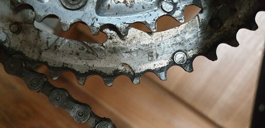

Get a new 50T if it's worn out.

99.999% it will be 110 BCD

measured 76+mm between 2 neighbouring bolts out of 5 indicates definitely 130mm BCD
stronglight chain rings look ideal thanks again
