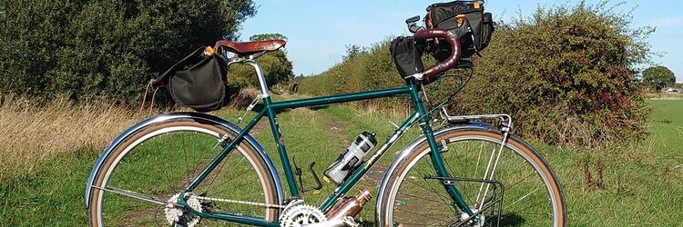

Basically I'm thinking bombproof do anything go anywhere. A tourer that does it all and I like the traditional pannier, full mudguard set up. In an ideal world a Rolhoff hub would nice too.
I think the legendary Surly Disc Trucker (Long Haul Trucker if not wanting disc brakes) is the go to bike for ultimate toughness and round the world reliability. However, as I don't have one I'll just waffle on about about the Spa Wayfarer instead :laugh:
I'll talk about the frame option as I built mine from scratch. Forks are included along with a headset. Looking around £475 I think.
First off, there are two versions. Short top tube and long top tube. There is I believe about a centimeter or two difference between the two frames.
Your average bike when built with a rear rack is around 14kg.
On the frame and forks are mounts for both disc brakes and cantilever or v brakes. If going for the rim brake option ensure the threaded inserts for the bosses are there. They were missing from mine.
The headset supplied when I bought mine was rubbish as it used needle bearings. Impossible to accurately adjust. Lots of reports on this issue so it wasn't just me. I think different headsets are supplied now but I'd check what type bearings the current ones have just in case.
The cons of this frame...
The rear seatstay bridge has been drilled vertically instead of horizontally for mudguards. Some folk are ok with this. I'm not. Getting the rear mudguard height adjusted correctly needs to be done right first time. Further adjustments mean having to elongate the drill hole in the mudguard which further weakens it. Spacers and all sorts of crap are needed to facilitate the height adjustment. It's a royal pita in my opinion.
The bottle cage mounts on the seat tube are way too high on my frame and I had to use a Topeak bottle cage adapter to be able to fit a standard size bottle under the top tube. I've been told this is an issue with my size frame only. 48cm.
It's very comfy. To the point that I think it isn't nearly stiff enough for a tourer. No matter how I pack the panniers, with front loads the bike suffers from shimmy. The previous Spa Touring had the same problem. I think the problem is with the forks. They seem very...springy.
It's slow. This is no racing bike.
There has been little to no treatment on the inside of the frame or forks against rust. I filled mine with engine oil then drained it. I still find rust stains on my seatpost from time to time despite greasing it.
The pros...
It's damn comfy. I can ride all day on this thing without being battered to a pulp regardless of the terrain and believe me, I've hammered the living daylights out of this bike on trails a gravel bike would tremble at. It's also bombproof.
It's slow. This bike is great for just cruising along at a relaxed pace enjoying the views. Which is what touring is about. However...I've had it going nearly 47mph. Steady as a rock.
Oodles of tyre clearance. I currently have 50mm mudguards fitted and there's still 1 or 2 mm clearance between them and the frame and forks. Spa say it'll take 47mm tyres. You can believe that.
The only mounts missing from the frame and forks are for spare spokes. I carry a flexible fibre something or other spoke instead. @HobbesOnTour carries the same things. Recommended :okay:
Basic thoughts.
The Wayfarer is no prince among pigs. It's not elite and won't win you any races.
What you get, if built with decent parts, is a comfy, long distance, bombproof bike that should if looked after, last a lifetime. There's even downtube shifter bosses on it.
Mine is 3 years old and has covered 2500 miles. Not alot really but other than the time I've spent getting my fit sorted out and changing its spec (drops to flats, back to drops, ebike conversion, flats again :rolleyes: ) I've had relatively few problems with it.
Spa themselves can build the bike to your specification including properly tensioned and stress relieved handbuilt wheels (none of that prebuilt Mavic crap).
From what I hear, the Disc/Long Haul Trucker is the king of tourers. It does come with a hefty premium these days though. The Wayfarer doesn't have it legendary status, but I'd bet my behind there isn't much between the two bikes.

Wayfarer on 700 x 42c Panaracer Gravel Kings
