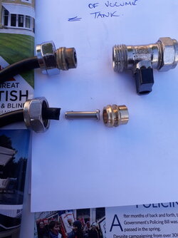

So.. I've still had no luck in sourcing a fire extinguisher, however did find this discarded on the side of the road earlier:
I assume courtesy of some local yoofs in a Vauxhall Corsa with a farty exhaust; as all the cool kids seem to be interested in aerated dairy-based deserts currently
It's ally, 0.95l, and rated to 30bar working pressure / 165bar test pressure - so should be perfectly adequate for my uses
Irritatingly while the fitting initally looks a lot like the ubiquitous 1/8" BSP, turns out it's M11x1.0 - very odd but probably intentionally so.
The thread in the bottle neck is a more conventional M10x1.0 and male-male adaptors are available to convert this to BSP; they're a bit shorter than I'd like since they're going into ally but at these pressures I think there's still a good factor of safety.
For now the plan is to see if I can lash together something using standard fittings, depending on what I can find on the net..
