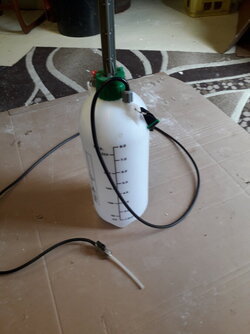

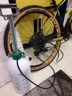

Used one fringe a 8L garden spray
Works perfect even for chunky mtb tyres
All you need to add is a quarter turn copper tube valve ...the tube inside the spray fits tightly over the wheel valve
Its get used in garden as well so not sn extra bit clutter around
