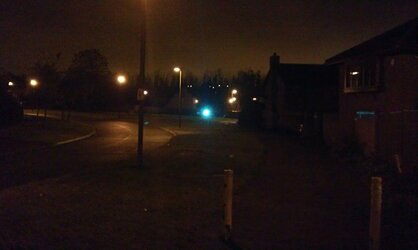

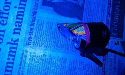

I made a little visor thing for mine after noticing that the light (mj872 with the clearer lens) was ridiculously dazzling even at a distance and needed angling down steeply to make any difference . The 3rd photo is taken 140metres in front of the bike with the light horizontal without the visor, you cant see any light on the floor at all by that point but the light itself is still very uncomfortable to look at. I should really take an "after" photo with the visor too! The visor is just a tester cut out of a Lilt can :smile: but when i angle it down a bit on country lanes it actually makes a good difference to oncoming traffic though and arguably the reflective inside of the can reflects more light downwards :smile: Im interested how the alternate lens work though, i guess theyre like the smaller parts of the mickey mouse mj816 lights :smile:
