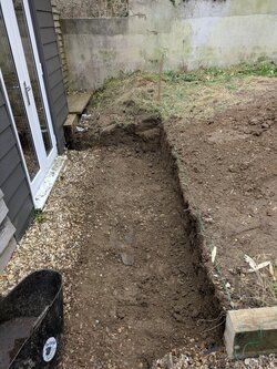

Here is the bottom slope end. The step up is now about 3 foot higher which I needed to do to make it level
